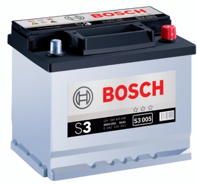

2. BATERIE BOSCH - tip S3 56 AH =68 EUR +TVA
Putere baterie : 56 Ah
Dimensiuni: 242x17 5x190 mm

TOTAL VALOARE PACHET CADOU: 214 EUR + TVA.
